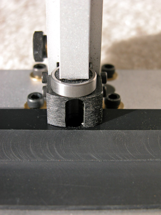

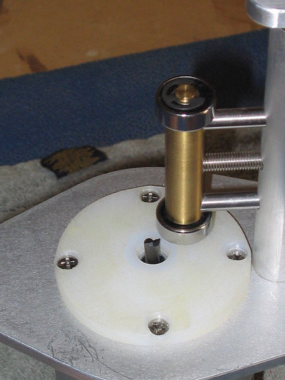

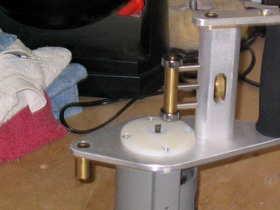

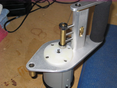

As promised, here are some pics of the Cochran prototype. I still have to build a cradle before I can test it. I'll post a review asap.

Hummm????? the bearings are off center from the bit in the plane of adjustment

I would think that you might want to consider adding a jam nut to the threaded depth of cut adjustment rod to keep it from moving during the cut.

You have to get out of your minds eye the fact that the adjustment and the D handle are not on the plane of action and keep the bearings and bit perpendicular to the body.
That said; This setup is a bit weird to me because having the adjustment plane offset means the amount you adjust is not directly equal to the amount of depth adjustment you impart.
I like the handle idea but I would want the plane of adjustment to be perpendicular to the cut rather than not quite tangent as this tooling is. The handle ma be in an ergonomic location, I am not sure about that.
PostPosted: Wed Aug 29, 2007 12:35 am
I guess I should have said what it is that bothers me is the fact the the as you adjust the bearing in or out, because the adjustment nut/bearing center plane is no in line with the bit/bearing plane. as you adjust this in or out you effectively alter the relationship between the D handle and the proper line of action of the cut. Now we are talking thousandths of an inch but none the less when cutting binding channels we deal with thousandths of an inch.

I suspect the bearings are in the plane of adjustment, I think our eyes are just playing tricks.
I like that the bit is not surrounded by plastic like on my luthiertool jig. I think next time, I may actually remove that piece of plastic and see how it goes. It's the black plastic piece above the bearing in Hesh's photo below (jig is updside down in photo), for me it can get packed with saw dust.

MichaelP, I think you are looking at an optical illusion. If you look at the screws that secure the plastic plate to the base you will see that they are in line with the handle and the center of the bit. The base of the handle is also in the same line with the bearing and the bit itself.
The close-up does look like the adjustment is off center but I don't think that that is the case.

Just to clarify. Mike is right, the center of the bit and the entire adjustment mechanism are all in line. It's just the angle of the photograph that makes it appear offline. And Bob, I wish I could take credit for this, but the only part that I built is the UHMW donut which is conical with a 1/8" flat spot on the bottom to compensate for the top/back arch. Bishop Cochran built the tool(See first line of the original post).

Tim, there is a hex head set screw that locks each of the two adjustment rails on the other side.

Wow I have looked very close at all three pics it looks off center to me but I finally figured out that the bearings are a bit higher than the tip of the bit. This in combination with the angle of the photos is what was making it look off center.
